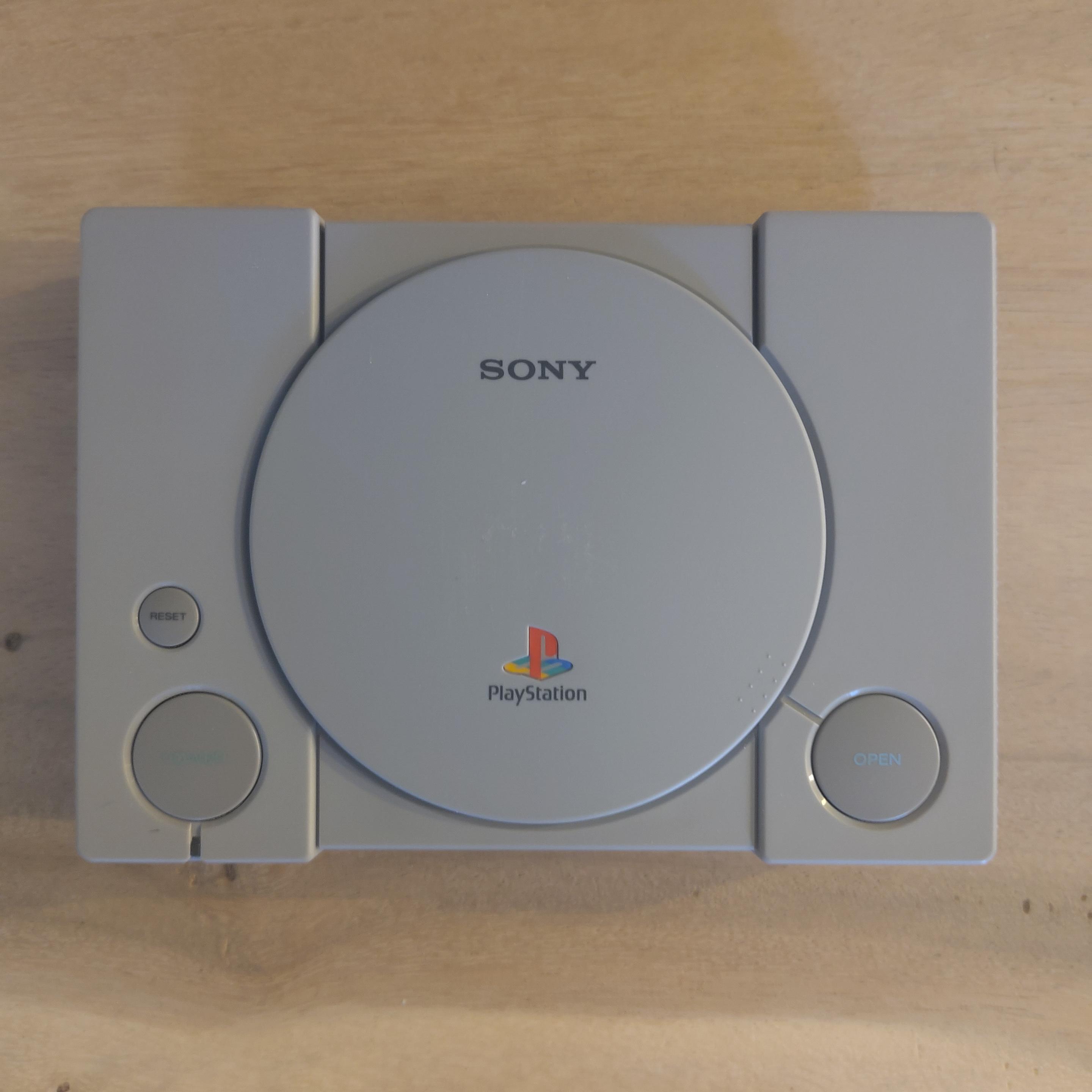

PlayStation Classic was a device released in 2018 to capitalise on nostalgia. It was clearly a cash-grab, which we know from the quality of the software layer. In fact, it was a pre-installed software emulator with 20 games and no way of adding new ones. And then, there are weird blurred filters applied that make games look abhorrent. However, and this is why i got it, it can be modded to just run RetroArch. And that is the project.
It came with two gamepads, which are replicas of the PSX first gamepad. I played 3 games ("Rayman," "Grand Theft Auto," and "I.Q.: Intelligent Qube"), and it confirmed that the rendering looks awful, but also that the gamepad is marvellous. I actually plugged one to my PC to play Amiga CD32 games, and it simply worked. I'll keep one of 'em around the computer. For retro purposes, it's superb.
By the way, it's shaped like PSX but is half-size, so it looks cutesy small. Like a toy. Which, I guess, it is. At least, it doesn't take too much space on the shelf under the TV.
