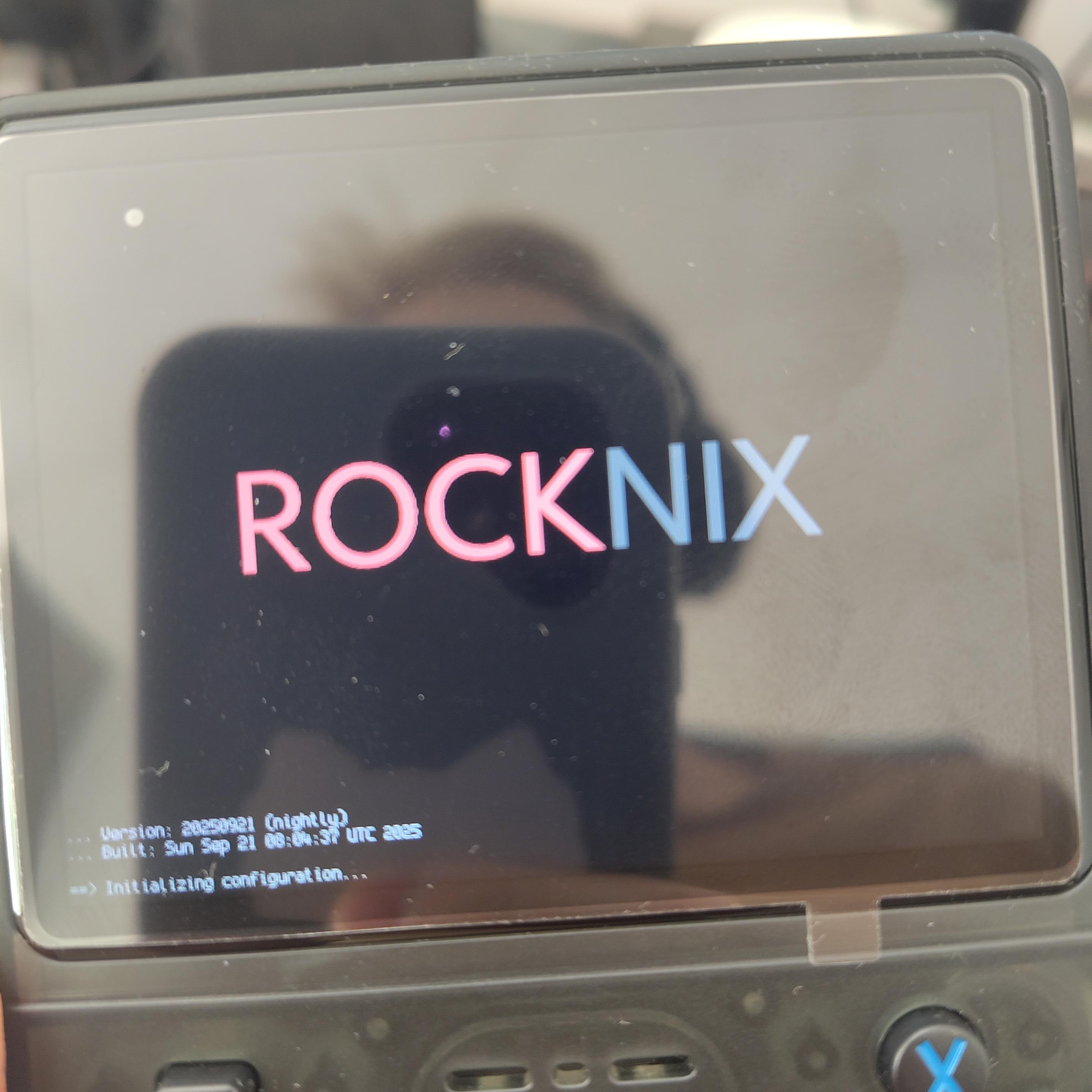

It could have been faster had I read the instructions well the first time around. But well, I'm a Pole and we don't read manuals.
A photo of a retro console with splash screen saying ROCKNIX
For my future self:
  1. Copy files from the original card (games and this file: rf3536k3ka.dtb).
    • A card that has been tested to work is this: Kingston Canvas Select Plus Tarjeta microSD, SDCS2/128GBSP Class 10, 128 GB
  2. Download the -b variant of Rocknix: https://nightly.rocknix.org/
  3. Create a bootable card.
  4. Create the overlays file here: https://rocknix.gosk.in/dtbo/ (using file rf3536k3ka.dtb), select 2-sticks variant and inverted headphone detection, then follow the instruction underneath.
  5. Insert the card into the device, so it can adjust partition and run initial config.
Note: Without rf3536k3ka.dtb, I would have to guess the proper panel from those: https://github.com/stolen/r.nix-distribution/releases/tag/panel_overlays. Doable if you lost your original file, but it would be trial and error.
